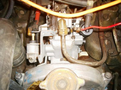

Pics just in case I missed something
First is just my big battery charger, I am cranking for about 20 seconds, then I come inside, second is my jumper wire on the IP and third is how I disconnected my glow plugs, I took off the big wire that goes to the battery and both of the little wires. I am leaving the key on to keep the electric fuel pump working when I come inside and the jumper wire on too, I read here that doing so will purge air, If I am missing something let me know, I am giving good long cool down periods (5 minutes) for the starter.

It started, ran ruff and died, I started it again ran ruff (like Mel says in his tech article), lots of white smoke, I shut it off to reinstall the air cleaner. Loud, noisy, I have not owned this or any vehicle diesel long enough as to what is the right amount of noise, I have two diesel tractors and know the noise they make.

Runs pretty smooth to me, a lot smoother at about 1,500 RPM, kind of lopy at idle. Will see how she starts in the morning, thanks much all.

I have to guess it was excess air, I cranked and cranked, (with lots of rest periods) just like Gary said, finally saw a little diesel at one injector then another. Never did see diesel at the one injector line I cracked at the IP, but I saw it at that injector!? Now I am ready to make her much nicer.
