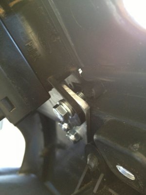

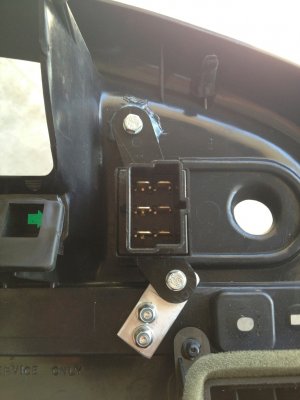

You need to add some reinforcement if at all possible. I used some aluminum flat bar I had laying around. I also filled the upper post with epoxy and built it up around the post, then drilled and tapped it for a machine screw rather than a self tapping screw. Mine has been like this for years, and works great. The lower bolts are hidden behind the trim panel that also hides the mounting screws for the dash bezel. It's completely undetectable from the front when installed.
