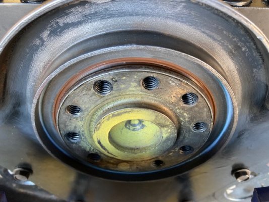

If you keep that OEM sleeve the SKF #38649 is what you would replace it with. I was able to install mine carefully without needed a special tool. I knocked mine in from the back of the plate with a piece of wood. Use Ford Motorcraft gray silicone on outer edge of seal before install. I also did not need the plastic install sleeve. I was able to wiggle this on carefully. The thickness of this seal is thinner than the OEM seal so it doesn't sit as far out in the bore. It sits flush to the inside of the plate surface. This picture gives reference from the outside once installed. You can see the OEM sleeve and how far in it sits.

Alright I looked at the sleeve and it has discoloration but there is not a groove I can feel. It also appears to be roughly.030" inches thick. This engine was rebuilt by a shop ~10k miles ago. You think this is the thick one it looks like yours? It's definitely thicker than the speedy sleeve post in the other thread linked above.
