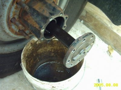

Ok, i wanted to service my rear axle just as i did on the front wheels on my truck 4x2(that is repack the wheel bearing) the ones on the front where easy but the back is a totally diferent story i did not find grease and the bearings use gear oil instead. I just got to remove one of the hubs on the rear wheel before i found out i cant put it back on place with out going any further, soo... any of you guys can tell me how to put this thingy back on its place please? I will need the truck later so i have to find how to put it all the way IN.
Thank you, Exekiel.

I used to put seals in my rollbacks on a regular basis. You should be able to push it back in with a little wiggling & turning at the same time. I would think it should be the same with your truck. Maybe the slpines arent lining up.

well Thank you everyone, i did come back in while turning it slowly . At the same time i put new shoes on the rear brakes, i think one of the rear cylinders is leaking very little cause i could see some dust (asbestos?) build up inside not only on the drum but around the cylinder itself and it was wet a could say minimal but enough to let the dust build up.

Glad to hear it went back in for you. Its a simple thing, but it does freak out people doing it for the first time. LOL LOL Just a matter of lining up the splines and then the boltholes. Having the axle jacked to turn the wheel helps with the boltholes too. Most of the time it goes well.... sometimes its a PITA.
If the truck is high miles and no recent brake foundation (lines, cylinders, etc) work done... the cylinder may be weeping slightly.
