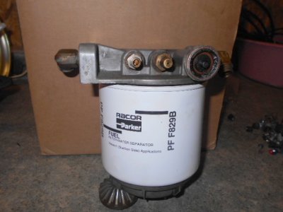

342
If your filter head has this on it, it could let air in if it's defective, fuel pressure will keep it closed, without fuel pressure keeping it closed it could let air in, it's not necessary and can be removed and plugged off.
Above refers to the fitting on the right side in pic, that is actually for air bleeding by pushing in on the button.

Yes i have the big ol trumpet on there. Is it just an npt plug that can be put in there? 3/8 or 1/2"? What do i plug itnoff woth?
Still doesnt answer how come the electric pump cant purge the air out? Or starts hard even after i manually purge the air from filter head as the pump is running?
