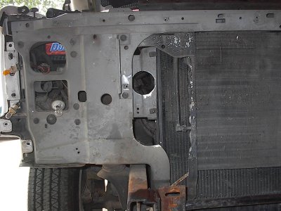

What a job! When you install a IC from Hypermax you have to cut 3" dia. holes through the rad support and the rad bolt flanges. It make sit very hard to remove the rad. I had to remove the top IC pipe and partially unbolt the IC so I could tilt the IC toward the grille. It was very tight to get out even then. 2 man job.
Before reinstalling the new rad I cutout a lot more from the flanges before I reinstalled it. It slid right in without any problem then.
If you install the Hypermax IC you may want to do more cutting on the rad flange before completeing the job. Saves time and possible damage to a good rad when it has to be removed.

did you happen to take pics? i'm installing my hypermax set up in a few weeks, pics for reference would be great.
chris
X2 we like pictures!!
If you'll go Here you can see my IC album.
But this is the pic where the rad support is cutout for the IC tubes. If you notice where the 3" dia hole is above and below you can see the rad mount bolts. I cut away ~ 2" of the flange above and below the 3" hole. I didn't rmove anymore from the rad support, only from the flange on the rad.

That hole is a real issue for us non-A/C equipped early trucks. Our radiators are still where that hole is. Makes finding a decent IC to use difficult.
