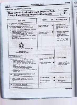

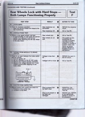

Just in case you want to check this.
Does the RABS and Brake lights self check when the key is 1st turned on.?

The sensor is the magnet. The ring is not. Pull it out of the rear end and check is it is fouled with small metal bits. Replace the sensor if needed. :)
Dave
