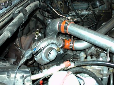

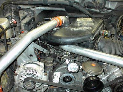

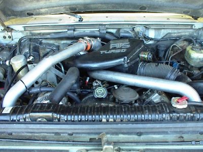

Has anyone tried pulling the whole cab/front clip assembly off like the newer superduties? I was toying with this idea because im looking at replacing the motor on it soon. The two major reasons why i want to try this is because it is TIGHT behind that turbo, and I have access to a lift
been there done that:D
I had a problem pulling the turbo off the '92 CC so I unbolted the steering column, the brake master and 4 body bolts. opened the doors and ran a short nylon choker around the "B" pillar and lifted the body with a cherry picker. Cut four blocks off a 4x4 and set them between the frame mounts and the cab and set the cab back down on them. That operation and pulling the radiator support made life a whole lot easier for me;Sweet
note... first two pics details the turbo area with the body lifted and blocked, the third pic is the body remounted.
