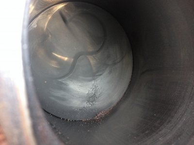

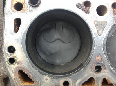

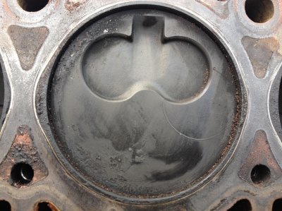

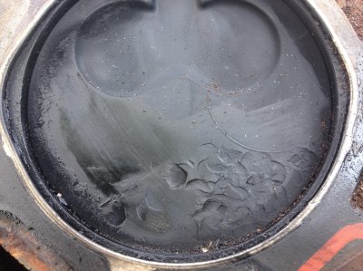

Pulled the drivers side head found the Pistons had gouges and pitting.
Many ideas what caused this?

Glow plug dented that pistong but another piston has both the intake and exhaust vles have hit it slightly.

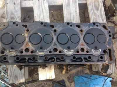

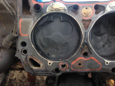

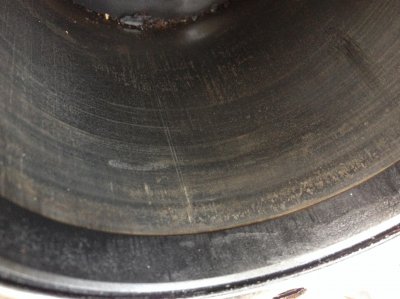

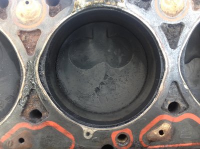

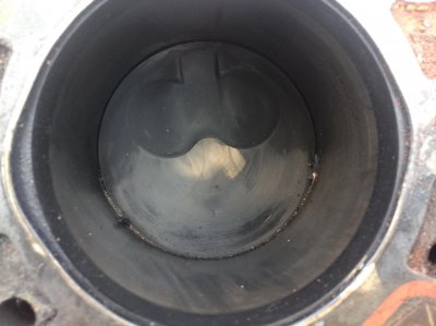

Passenger head is off. Pistons look good no pitting just some carbon build up.
Cylinder Bores look good some cross hatching nothing major. Work stops until I get a stand that flips. Then we will take a peek at the bottom end.

With valves kissing like that already, if you machine the heads or deck at all, it'll cause problems. Obviously ensuring the valves are in spec (they may not be) might help, but you should be looking at pistons with reduced height (what's the technical term?). They do exist. The alternative is to machine the Pistons, but since you are buying new anyway...
Personally I wouldn't put it back together even the way it sits knowing that has occurred.
On the flip side, none of that damage from glow plugs appears to be on the edge of the Pistons. You could theoretically take some off the Pistons and reuse, depending on how far you plan to go with this rebuild. If just re-honing and not boring, not a bad option. Budget/ build dependent.
