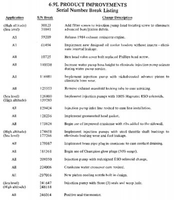

My engine is an '85 and it has the pressed in piston cooling nozzles the change took place in '86 I think and there is no place to drill and tap a hole for the bolt in nozzles
X2 on that...FWIW according to the attached list, the new design started with block # 237016. I've also heard from multiple sources that there's no practical way to retrofit the bolt-on nozzles to an earlier block. Unfortunately, I thought I had also heard that the press-in nozzles were one-time use items and were starting to be difficult to source...for that reason and concerns about the weak sidewall, I've actually put some thought into putting a different block in my truck if/when it comes time to do a rebuild (my block is a late '83)...
