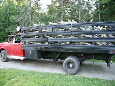

the 87-97 f-sd/f-450's only came with hydroboost (and 4 wheel disc brakes.) none of them came equipped with vac brakes..........if they did you wouldn't have been able to stop them hardly when empty,let alone when loaded.:D

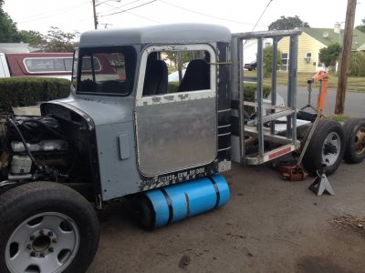

ah, ok thanks, my pedal assembly is from a 92 IDI f350, as i am converting to a manual (motor is a 90 IDI auto w/vacuum) and putting hydroboost because of firewall clearance on my mini peterbilt. a Vacuum booster, that i have, wont fit under the cowl panel, but the hydroboost has plenty of room. sorry i wasnt clear or give you all the info needed. so, let me reask the question, what do i have to do to make the hydro boost work with a 92 F350 pedal assembly. thanks guys!!!! funny thing is, originally i was building this truck on a 90 F-superduty frame with a 4.88 rear....but the 10 lug alloys were $$$$$$$$ compared to the 04 chassis and axles im running now (4.10 8x170)
