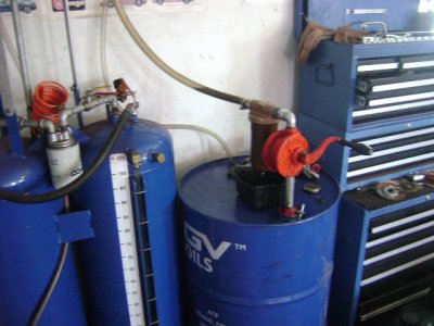

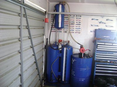

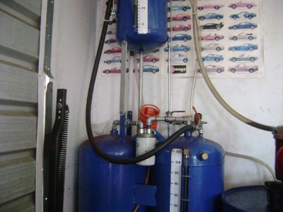

Here's a picture of my oil cleaning "upflow processor" , I got the idea from the vege oil crowd and it works great

Your setup looks great, I like the compactness?? of it. ;Sweet
What kind of temp swings do you have from summer to winter?? And does that have a bearing on your % of wmo use?

Glad you liked my processor, I really detest having an oily mess in my garage. I painted it blue so it wouldn't look like an explosive device [ attracting unwanted attention ]

My upflow processor tank is only 105 liters [ 27 gals ] so on a six day cycle it can produce 17.5 liters per day [ not much you might think ] but it can be increased to a 4 day cycle producing 26.25 liters per day
OK my Mitsubishi Pajero [ Montero in the USA ] gets 10km per liter which is 24.25 MPG .
Because my upflow produces 17.5 liters per day 24/7 without complaining I can produce 6387.5 litres per year [ 1646 gals ] which is enough for me to drive 63,870km's per year [ 39,915 miles ] at 100% oil
With a W85 blend this is equal to 75,141km's [ 46,959 miles ] per year
The world average is only 25600km's per year [ 16000 miles ] , So storage is very important.
My upflow also has a mixing funnel and a recirculation pump but I removed this because I now don't bother blending until I am ready to use the fuel [ It saves me parting with money until the last minute ]

neat system, can you elaborate on how it works? i have been mixing WMO in my fuel for about 5 years or so with just a regular filter set up. i recently have picked up a centerfuge but have not had time to set it up due to 2 jobs, 3 kids and some unexpected house projects.
