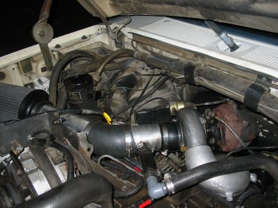

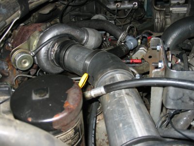

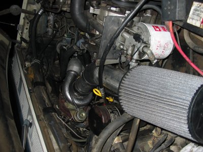

Well, these are dark pics and all, but so it goes. I made a new filter bracket and it all fits really well with the big AEM filter. The CDR is hooked up in the valve cover to the intake tube.

Great job on the intake. If you had a chance, could you snap a picture or two showing how you set up the CDR and associated plumbing.
I am about to go the open air filter route, and need to plumb my CDR. I have a RDT currently, but am getting the stink eye from traffic when at idle. I also had a tire shop tell me that I needed to get it fixed (they thought I had an exhaust leak) before I bring it back.

Bgfire, I used a factory turbo ATS valve cover with the bracket for the CDR attached to it. I put an extension on the hose from the factory turbo kit and put a piece of 1" aluminum tube in the side of the 3'' aluminum intake tube. I just cut a hole and used some of that handy aluminum fluxing rod and a mapp torch.
Have a looky at the other setup I had before I went and swapped turbos. It may help to see the filter coming in on the other side.
http://www.oilburners.net/forums/showthread.php?t=15505&page=2
