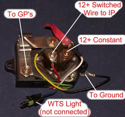

I was working on the battery cables this evening, and after all the positives were hooked up, I hooked up one of the negative cables. I then heard what sounded almost like a sizzling noise, then a POP and some pretty smoke came wafting out from the passenger's side inner fender :mad: followed immediately by my heart sinking.
So, I blew something...and I think it was the new 7.3l glow plug controller that I had just installed (haven't removed it yet). The big problem is, I don't know why. AFAIK, I hooked everything up properly (see diagram below for how I did it).
After seeing the smoke, I CAREFULLY hooked the negative terminal back on (this time, with a fire extinguisher handy), and it seemed like everything was fine. I then realized that the wires at the injector pump were energized (with the key off and in my pocket). I disconnected the switched power connector at the controller, and tried again. This time, the wires at the IP weren't energized, so I took a test light and put the probe on the terminal I had had the wire hooked up to, and sure enough, it had constant 12 volt power...and this was with only the big wire (the constant-power wire that's supposed to feed the glow plugs) attached. Now, if the glow plug controller were getting its power from this terminal (through the red wire shown in the picture), shouldn't it have been cycling? It definitely was not (I don't know if it ever did or not).
As things currently stand, if I hook the cable up, everything else seems fine...cab light comes on, buzzer works, radio comes on if I turn the key ON, etc.
Any thoughts? What did I do wrong? Or, is the controller doing as it should and I need to be looking elsewhere? I'm not seeing any other obvious problems.

How would this blow a fusible link? If this is on the constant-hot side, I ran a new wire straight from the battery to the 12+ constant terminal on the controller. The wire to the starter relay goes from the GP controller to the relay. If you're referring to a fusible link in the wire going to the IP (that is also powering the controller, at least in theory), I checked...with the wire not hooked to the GP controller, I AM getting power to the IP wires with the key ON. Also, if a fusible link was blown, why would the 12+ switched terminal on the controller have constant 12v?
Other than the issues relating to the controller, I think my electrical system is still functional...if I had the other negative cable finished, I could probably crank the truck (although I haven't tried this).
Sorry if I sound a little terse; I desperately need my truck this weekend, and I need to get this done PDQ...
Thank you again!

Tim,
If I am reading this correctly...
When you have the key in your pocket you have 12v positive on the small red wire at the glow plug controller? This is not correct - that says to me that the relay on the fender that is the main relay for the electrical system is "ON" for some odd reason and we need to figure out why... Typically when a relay fails it will fail in the "OFF" state but that does not mean that the contacts can't arc and weld themselves "ON" but I don't see that too often - actually only seen it a couple of times and then only in high voltage application (480 3 phase where high current is present).
The relay that I'm talking about is called a starter solenoid on the fender and it's pretty cheap if that's your problem - test it first don't just throw parts at it...

I'm 99.99% certain that I found the problem. The wire coming from the battery (a 4 gauge cable) has a lug on the end to hook up to the terminal on the controller, and a part of the lug that was bare metal was in contact with the heat shrink on the white ground wire going from the relay to the controller. I guess the heat shrink on the white wire wasn't as good as one would expect, because it looks like electricity burned through the heat shrink and put a truckload of 12 volts through a wire that's supposed to go to ground. Take a look at the picture; I'm holding the wire in my hand, and you can see where it burned through. The big cable in the foreground is the wire going from the battery to the controller, that the white wire shorted to. The black dab on the lug is just liquid electrical tape, to seal a portion of the connector that the heat shrink didn't get. There isn't a mark on the lug at all where it shorted out, surprisingly enough.
If that didn't fry the controller, I would be shocked...but at least it looks like I (hopefully) had everything hooked up properly, except not having enough clearance between the white wire and the 12 volt constant-feed. OTOH, it looks like my glow plugs are still happy :) (actually, I'll bet they didn't activate at all)...I ohm-checked them all, and all 8 passed.
Now, can I find a controller at a semi-reasonable price that can be in my hands in the next 24 hours? *sigh*
Thank you...and thanks for the funny; I'll read it when I'm in a better mood ;)

Oh almost forgot it appears that from your pic that you wired it correctly so I doubt that was the cause of your problems but before you go throwing power back on - double check your connections just to be sure... Sometimes a guy can get in hurry and land a wire in the wrong spot - not saying that is the problem but it's worth a look see.
Travis, that's correct...but, that's 12 volts positive on the small red wire when there is NOTHING else hooked up to it. It looks like the 12 volts was feeding from the short-circuit that I just found; otherwise, the only way I can imagine 12 volts getting to that terminal would be if the GP relay shorted out internally...
With the short corrected, I am no longer getting 12 volts at the small red wire...so, I imagine the relay's okay. Not that it matters, though; although I haven't tested it, I'm still just about certain that the circuitry in the controller's fried...too much smoke and burnt electronics smell for it NOT to be fried...
