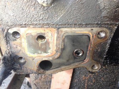

Here's my oilcooler it was put on lightly. No leaks or ****** berrys

Looking at that pic closer, that's not actual rtv. That's off the gasket.
Looks like anyways.
Looks like anyways.
Sent from my SAMSUNG-SM-T337A using Tapatalk
also looks like some of the gasket material on the left side of the bolt holes...
if that was a RTV job, someone did a crappy job cleaning off the old gasket ;Really
