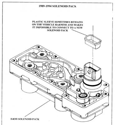

Update: Thanks for the help everyone, turns out the solenoid pack was bad and I got into it this past weekend. The removal and installation went smooth until I went to plug the harness into the solenoid pack. It would not fit, closer inspection found a "ring" around the plug that would not allow it to go all the way into the solenoid pack. The connections themselves are matching but the housing is a little different. Thought about shaving this section off to get it to fit? Any experience with this?

I was able to get the plastic sleeve off that fordF250 mentioned and the plug fits into the solenoid pack.
After a test drive things seems to better, but not completely...
From a stop the truck acts like you are driving a manual and riding the clutch to take off in third. High RPM's to go very slow, as if you are starting in third gear but not lugging, like the tranny is building pressure? Once you are in the 10mph range it runs fine. If I manually shift to second it takes off much better from stop, yet I don't have a first gear anymore.
I hope this makes sense.
I have replaced the FLPS and Solenoid Pack to date. Tach and Speedo work fine.
Thanks for the help.
You might need the correct 89-94 solenoid pack.
