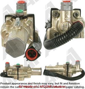

This is the part you will be looking for....
It is located inside the frame rail on the drivers side. roughly around were the firewall and cab floor meet iirc.

dakotajeep
Patrolling
Aug 28, 2007
1,187
TN/ND
Eric,
Did we just became best friends? (quote from Stepbrothers if you missed the joke...)
Thanks a ton...so bypassing this is not going to screw up my brakes or anything crazy right?

Eric,
Thad
have not seen the movie. no your brakes will be just fine. the way i understand how this thing works is it is just a bridge i guess you could say for the fluid to go to the back brakes. then when the VSS in the rear pig senses a to rapid deceleration rate the RABS valve acts like a waste gate and just dumps brake fluid to somewhere in the RABS vavle until normal wheel speed and brakeing conditions are resumed. i have heard some guys on here say that is the first mod you should make to these trucks.
http://www.oilburners.net/forums/showthread.php?t=48158
Follow the link. on the first page is a picture of my MC. the thing that i have labled the proportioning valve is what controls pressure to the rear brakes so they don't lock up as soon as you touch the brak pedal.

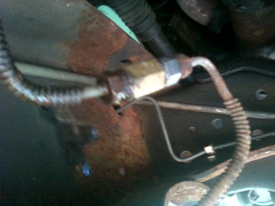

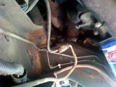

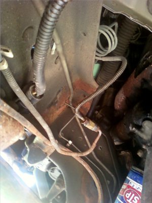

Morning Thad
Here are the pics. they are off my '94. i hope it is the same system as on your '87. i am sure it will work though just to show you how i bypassed my RABS valve.

Eric,
Looks fairly simple. Just curious if the threads are crazy random or not?
