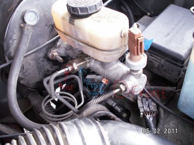

I have 2 lines coming out of the m/c. Correct me if i am wrong but doesn't the front line on the m/c go to the front brakes & the rear line go to the rears. I have a proportioning valve coming off of the rear fitting on the m/c. Does that have anything to do w/ front breaking action?

Today when i got home from school i jacked up both front wheels. Then gradually loosened up the nuts that hold the m/c on. i moved the m/c completely away from the booster and i had no change in brake drag.
What does this tell you guys?
