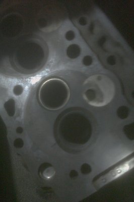

Homeless... Please tell me where the leak appeared using the pic of the ruined head with the cut intake seat. I may have an idea if the leaky area is where I think it is...:sly

In the picture , you can see on the bottom right where the gasket didn't seal . It is the worst right under the rectangular coolant jacket .

oops , forgot the picture. One sec..
Edit : In the picture it looks like the whole exhaust side isn't sealing , but its really only right between the exhaust valve and casting numbers .

Sounds like you have some issues. If building air pressure in the cylinders causes the water pump to move.. Well thats not good. And if no pressure will build because the air is getting past the intake valves.. Thats really not good either.. Any chance this engine had a set of head gaskets installed before you got it.. If so maybe someone didn't know to torque the heads correctly. What do you know about this used engine.. I was thinking that the leak may have been because one of the precupsstuck out of the head more than 5 1/2 thousands... That has happened before on another idi site. The owner felt he had to use thread sealant because water was coming up the head bolts and leaking out... turned out his precup stuck out of the head too much... The factory set is + or _ 2 1/2 thousands...
