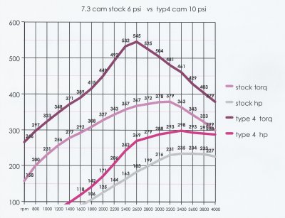

ok I have been running Performance trends engine analyzer program to find a better performing cam grind. Oregon cam grinding inc has a chart of lobe profiles to try. I ran 6 grinds that were on the chart, none made more power and torq than "type4"s Cam profile. the biggest problem with the stock cam is the 38* of overlap. then the 240* of intake duration and 250* of exhaust. the "type4" cam has -13* overlap and 187.5* duration intake and 198.6* exhaust. this makes the effective stroke 4.13" vs stock 3.76" this by itself increases the volumetric efficiency from stock turbo 6psi 97% to "type4" cam at 10psi 131%. I have alot of data to show this is a verry good grind to install in a stock engine with no mods. the only thing you need to do is if you dont change your lifters you need to clean them verry well because the lifters will need to "pump" up to take the slack out of the smaller base size of the reground cam. Check out this graph stock turbo engine 6psi boost vr "type4" cam 10psi to show a little mod and cam goes a long way. same fuel setting.

Oh, I am not doubting type4's cam at all. But like you had stated, and engine that is stock with no mods. I am looking for a cam to to work with an engine with mods. I will not even be operating in the same rpm range. I just had my pump modified to spin my engine up to 4200 rpm, and I plan on porting my heads at a bare minimum. Type4's cam is great no doubt, I am just looking to take it to the next level with more lift, and different durations. What I need now is the information to tell me how much lift I can out on the cam with getting the valve to close to the piston. If someone has that info please advise. I am looking to go pretty close to the piston to achieve some good lift. let me know if you have that info.
