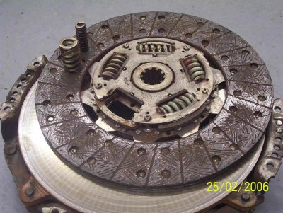

This pic here is of one that's got 3000 miles
on it. Supposed to be good for 350 plus rwhp. :rotflmao
Anyways, it looked like this when it went in,
minus the broken spring. They don't have a ton
of meat on them to begin with. Can you post a pic
of the one you want to use? Then we can compare
and help you decide. A poll? :thumbsup:
