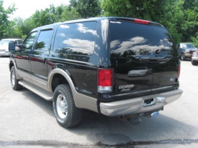

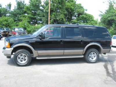

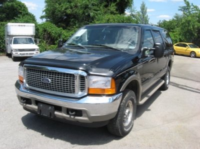

Hey all just added this 2000 Excursion to my family. It has 96000 on odom and I got it for a steal. It is a 7.3 with either a chip or program according to the dealer. I am unable to rotate the hubs from auto to manual. Any one have some suggestion as what to look for or do to repair these? It also has a leaky water pump, all ready got a new pump (not reman) to install.It has two small dents one in the bumper and one quater size dent next to fuel door I let Aric and Danielle look it over and take it for a spin they gave it there approval:rotflmao
