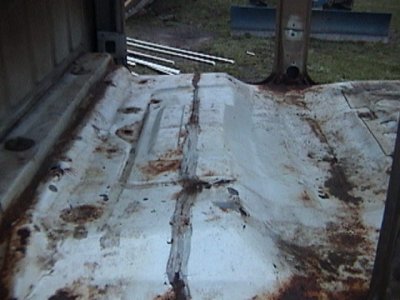

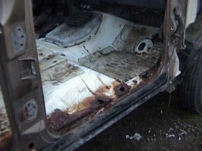

Well here are the drivers side uglies for the night.
Any ideas as to getting the seatbelt retaining bolts out of that mess? :puke:
I might be overacting a bit but a welder I am not yet. :confused:
the drivers side is the worst from underneath but dang does that el cheapo carpet hold the moisture.
Even had fun getting the front seat out. -cuss

Well the main thing is to remember this is going to be under the carpet most of the floor pan will be easy don't try to make one piece to fit it all replace pieces that you can get to fit it will be more welding but way easier to get your pieces to fit rightremember to brace your cab if your going to cut that rocker out or at the very least take some detailed measurements first so your doors fit when you get done

:eek: WOWZERS!
having lived south of the line since '70 I forgot how bad the rust can get :eek:
Crap Ron.......looks like it's more than just a hole patch eh?
I'll look around my area and mebee when you go to Virginia
and if I find a good donor.............. :thumbsup:

Looks like I'm gonna try to replace the bad areas as I can get front floor pans but will have to patch the rest. The seat belt retainers on the floor are my only safety concern as I'll prolly have to cut them out to get em removed for sandblasting. :mad:

Looks like from the pictures that the supports are going to have to be repaired/replaced as well. I think I would go for a southern replacement myself then rust proof the heck out of it so that it will last another ten years... We used to use a lot of washer and dryer doors back on the farm when replacing floor pans we would rivet them into place then slap on the sealer with a brush - would hold for a few years. Welding would be the best choice but we didn't have a welder at the house so we did with what we had.

In my experience chasing that much rust, those cab prices don't look bad at all. Once you cut away what you can see you'll find the rest of it.
