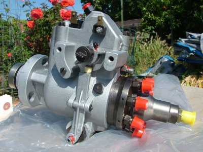

gandalf
Senior Member
Jan 21, 2005
3,885
1,075
CA &/or Maine
I've just gone through the same thing. I drove home one night after having the engine timed, and it would not start the next morning. The pump had died. See my previous posts on that subject.
The FSS wire in on the top of the pump, driver's side, toward the front of the engine. It has a spade connector. Both connectors on top have spades, but they are different sizes. The FSS has the larger spade.
I'll attach a picture of my new pump prior to installation. There are things not yet installed on the pump, but the basic configuration is there. In the picture you're looking at the driver's side of the pump. The red and yellow caps face the rear of the truck. The FSS connector is at the top of the pump, on the left in this picture.
I finally faced reality, and bought a new rebuilt pump and new injectors from Typ4. I have a happy engine again.
Hope this helps.
