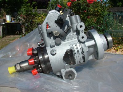

The part numbers and such should be found on the side of the IP. The data plate will be on the passanger side of the pump.
Their warning seems a bit confusing to me, so I'll assume there's something we're not getting.
