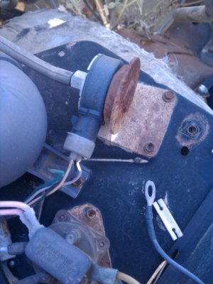

Anyone know what this is and what it does? The little thingy with a vacuum line and electrical plug that sits northwest of the GP relay. Does it have to do with the cruise control? Its on an 86 f250 6.9, t-19.
I am waiting for my factory service manual to arrive but the suspence was killing me. Thanks.

Its a low vaccume switch.

Just turns on your brake light on your dash to let you know its low. This lets you know your brake booster is not going to work,making the pedal hard and brakes not work
682
Yes... Thats what it is but.... When you loose your vacuum a dash lite comes on telling you... Low Vacuum..... Hopefully you can stop the truck when you see this. Usually its way too late when you see this. When its happened to me I "found it" when I hit the brakes only to find a million pounds was needed to push the brake peddle. But steady pressure will slow you down. Find a country road and remove the vacuum pump belt and drive slowly and try to stop. This will give you a feel of just how hard it is to stop these rigs without vacuum assist brakes. Change to hydroboost brakeing and you double your line pressure cutting the peddle effort in half to stop these rigs....:sly

Kind of like i said your brake light comes on because like i said the vaccum was low

What does it do?... Chances are, nothing anymore. Most of the things haven't worked for years. you should test it and if it's not functioning eithr replace or block it off, they are a major potential leak point when old and worn out.

Well thats a yes and no answer. No... It wont cause your cruise control to work or not but.... It will tell you that you have lost your vacuum so the cruise control wont work. Vacuum is what makes the cruise open or close the throttle.

True that. I guess I meant electrically. But ya'll have answerd my questions. There's a few idi's in the local pick and pull and I was rapin and pilligen them for cruise control parts and wondered if I should grab one of those switches. Now that I know excactly what it is I can choose my parts wisely. Thanks guys.

Thanks for all the replies. So this thing has nothing whatsoever to do with cruise control, correct?
Actually, it can, if the thing is leaking like a sieve like mine was, your cruise won't function ( and your brake pedal will get a bit hard, also ac/heater controlls will act buggy)
