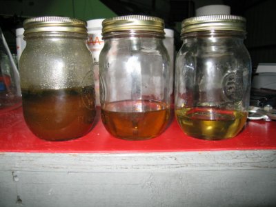

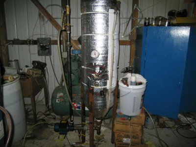

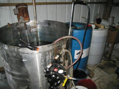

Here is some of my process stuff I have made over the last couple of years, I can run about 40 gallons at one time.
It is messy but I can pass the 3/27 test.
The jars are: left, crapy veggie oil I get, middle is the bio made from it and right in good once used veggie oil into bio.

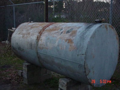

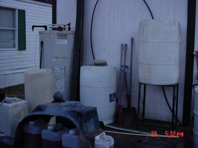

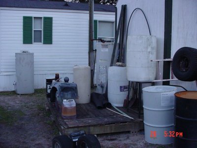

looks good, what is the mixing tank for? what is the processor made from? and what size?

My processor tank is made from bits and peices from work, we have rollers and seam welders. the conical bottom is from a vacume system.
The big mixer tank is a stainless steel tank a friend gave me, the cone shaped bottom just make a good settling tank and holds about 150 + gallons. I settle in the two plastic drums first and then settle it in the big mixer tank. I heat it in the processor for two hours before processing with the pump running, I have a 4 inch axcess hole in the top I can leave open until process time allowing a little moisture to escape.
I started with a 12 gallon processor from a small WH tank, once I prefected the process I made this 40 gallon job, works very well, even though it is tall and skinny I feel it drains better than big and round.
I can process 120L / 22L Menoxcide and still have room to do a 5% prewash at the cycle end.
