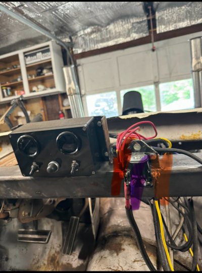

Chances are it’s the ignition switch, rod, etc along those lines in the column. It’s a bricknose thing. Jump the starter relay. If you don’t know how send pic of your solenoid.
hacked89
May 30, 2018
1,902
2,599
Bucks County PA
there’s different style relays but all the same concept. You’re going to have highlighted red below the always hot from the battery. In the purple highlighted area you’ll have S and I. S is energized when you turn the key to start. It then allows the electricity to flow from Red to Orange below. Orange is the low amp triggering wire for the starter solenoid. The starter motor when receiving the signal from the low amp line then initiates the high amp red feed and that’s what turns your engine over.
To summarize, just connect S and the always hot battery side of the starter relay with a screw driver with the truck in park and ignition turned to “on” position.
If that doesn’t do anything then the relay may be bad and you can jump red and orange at the relay.
