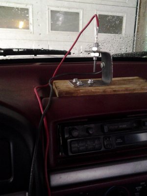

Follow up for those interested.
Finally got my new plugs. I mounted a 9th plug on my dash, and love it. typically takes 9 seconds to turn it red. But on subsequent start attempts, depending on how long you pause, 3 seconds or so is plenty. Really like the ability to see what I'm doing!

Just a basic no frills mount. still thinking about what I want for a more permanent solution.

One more try.

That's rather interesting! I think it would be great to see the progress of the heating of the plugs. But with my luck and how things have been going I'd end up with a BRAND mark on my forehead, or at best hand.
Not that I'm THAT clumsy, but weird things have the tendency to happen to me.
