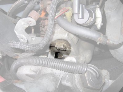

So you'd suggest advancing the IP a bit more? I just looked at it, and getting to that one bolt on the passenger side will be interesting, to say the least... Also, I remember in an article I read either here or at TDS it said to use a 3/4" wrench to turn the pump - well, I couldn't find nothing to slip that wrench on, can someone post a pic of what I should grab on the pump to turn it? Thanks!
Here's what you're looking for...

Thanks man! Just advanced the pump a bit, like 1/8" at the marks, man was that bolt on the bottom passenger side a pain to get to! odd thing when I loosened all three bolts the pump just stayed there, if I put the wrench on it and try to turn it either way it would just return to that center position, and there were two marks there that were lined up, so I guess my pump was never advanced. haven't fired it up yet, gotta find some cardboard first as the exhaust pipe is pointing straight at my Lincoln's front end and I'd really like it to keep that sparkly blue color it has ;)
