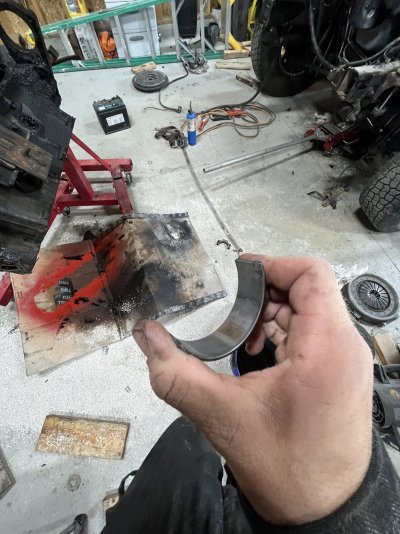

Update: found a new motor put it in put the injectors of the knocking motor in the new to me one no knock
Tore the motor down no exhaust leaks at the manifold, and this was the worst rod bearing
Truly a mystery
