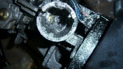

Well, I scored this nice steering column from a 97 I was GOING to put in my 92 but all teh instructions I found for getting the old lock out led me to drill right through the friggen gears in the column. It was being stubborn as all get out. I would have had better luck with a slide hammer as that was essentially how I fianlly got it out beating on the wedged in screwdriver with a sledge hammer.
Anyway, since that assembly is pooched, can I just mount an ignition switch from an older model or a generic ignition switch and toggel start on the dash somewhere, or do I risk a steering wheel interlock flopping down from somewhere and bitting me when I least expect it. The wheel rotates freely right now

you can see the drop down pin that locks the column you can remove that if you are worried about it dropping...

My 92 column the bearings in the head are shot. the PO must have been a 400 lb gorrilla who liked to use the wheel as a grab handle. It's so bad that he even bent the mounting brackets . Teh wheel flops all over the place.
The new column I picked up was teh first decent one I've ever seen at teh boneyard and it's nice and tight.
Here's a couple of pics, they aren't very good. I wound up drilling right through into the chamber where the gears are. The rack gear is still intact but the pinion gear was toast. Still not sure how this happened. I was stopping every mm or so and checking and I never saw anything but solid metal at teh bottom, I even dug around and poked at it and nothing flimsy poked through. It makes no sense, but when I whacked a screwdriver down in there I got it wedged in and then I was able to finally whack the works out with a hammer ( never could turn it like everyone says will happen ) but I had gone all the way through the gear somehow :confused:
Pictures stink, but its hard to get a shot down in there.
