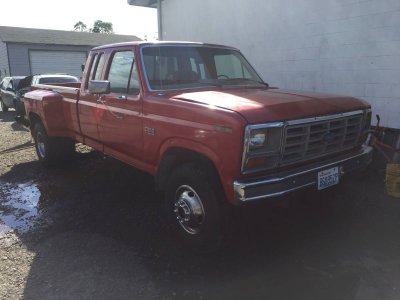

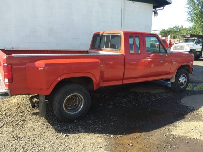

Picking this beast up in Walla Walla, flying in Saturday morning and driving it back 330 miles!!

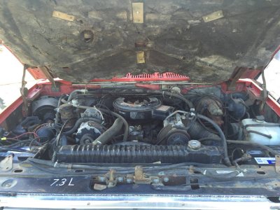

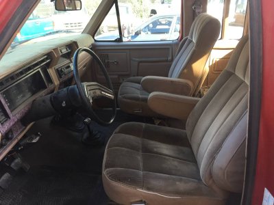

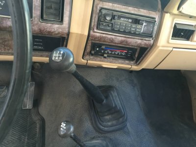

I don't know her exact history but it had a 7.3l swap in 96, then it looks like it was driven until 2000 and parked for about 15 years, I ran an Autocheck. I had it inspected locally and as it turns out the shop owner knew the previous owner (yay for small towns!) he told me the guy was a helicopter pilot who took good care of his equipment, the motor came back with flying colors. there was some confusion in regards to the Tcase, it has the wrong knob and the shop couldn't shift it. That means it's a Tcase from 88+ right? I don't know when the ZF5 was swapped in. Shop also said there was noise from the D60 diff, but no slop in pinon. Maybe the hub seals? Tires were bald in the rear but the seller agreed to put 4 new Cooper AT3's on her. For a minute it looked like I would lose her to another buyer after the inspection results and price negotiations but the seller stood by his word. I'm pretty excited and feel great about the deal I'm getting, as long as there are no surprises of course.

Nice looking truck! Hope you have a good trip.
That **** knob is for a NP205 out of a 70's truck. It's a big cast iron transfercase. So if you look at the transfercase and it appears to be aluminum/magnesium it's not the 205 and has a different shift pattern. It's almost exactly reverse of the pattern on that knob.
Front-back (1345, 1356 shift pattern)
2wd
4wd
n
4wd low
Very nice looking rig. I noticed 2 items that demand attention before anything else is done. The cowl seal just above the air filter housing is damaged. A piece is missing. See the wet top of the filter housing. Thats rain water leaing in. If the wing nut that holds the filter top does not have a rubber and steel washer under it you are going to sure as hell get water in the intake. Thats the bad nature of these beasts. So please check and fix that before you hydrolock the engine with rain water. It has happened to others.
Now the second item I see it what appears to be a small tail pipe. From what you posted it seems like this truck had a gas engine in it from the factory. I see the 7.3 written on the rad core piece and the filter housing it says 6.9. These are not knocking your purchase. Just things I see and felt you would like to know. I like the dually look on that extra cab.:thumbsup::thumbsup:

Thanks for the input. I'll check the transfer case right away. The skillet stirred me out shifts into all modes. I thought it might have been
_2H
_N
4H
4L
I'll find out for sure once I'm there.
I didn't notice that water on the housing, good eye. I'll check for that. What part is missing? Is it possibly from the bent hood, they backed into it with something. The forecast is going to be sunny for the drive home too.
It had a 6.9 from the factory and was a F250. I don't know when it was converted to a F350. Looks like the sterling will be a full floater but I'm not sure on the D60. I'm planning to at least drop then cover and replace the gasket, if that doesn't stop that leak then I'll look at axle seals as a next step.
Along the edge of the cowl is a rubber lip seal. Just above the filter housing you can see a piece missing. Best idea is place a large trash bag over the air filter housing so any water that gets on it will drain off instead of staying up there and eventually getting into the intake. Cut the bag to fix the housing. But the heavy duty bags. Really any heavy material plastic bag will work fine.

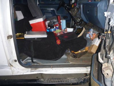

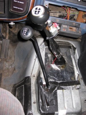

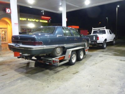

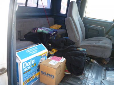

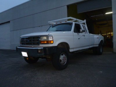

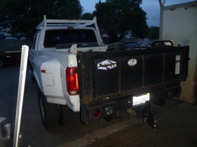

Congratulations. Any for pickup owner who sees your truck will know it was built with a purpose, not bought. if you ever owned a supercab 4wd truck, you'll wonder why Ford didn't build this in the first place. For starters, the ability to make a U-turn like a regular vehicle is positively priceless. Secondly, the ride is night and day in comparison to the reverse arched D50 springs. You have a true pickup dually 4x4 there. Your VIN sticker with it's specs are only a starting point now. here's a few pics of mime. not pretty but functional and I work the hell out of it. :D

That's a strong looking rig right there. It wool be a long time before I could afford a gear splitter... I did see some cheap P type laycocks but not abt adaptors.
Function over form all day everyday! I look at these as tools first and toys second.
