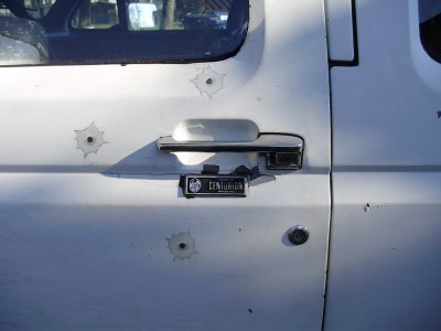

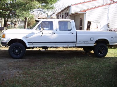

Just got my crew cab home this morning;Sweet Its an 89 350 4x4 centurion conversion truck it was origanally a dually but the last owner converted it back to srw
