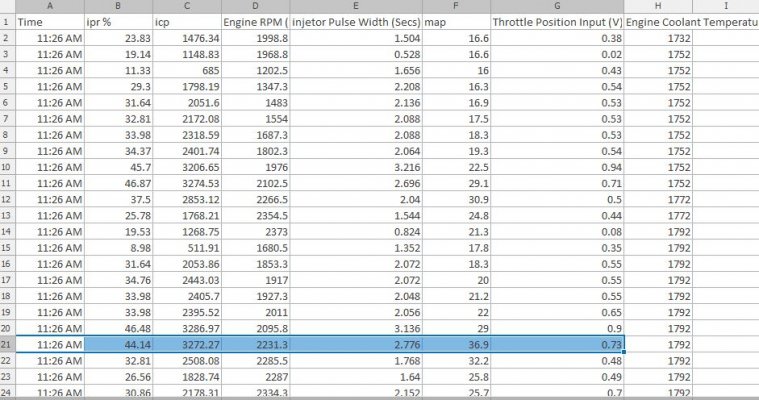

have you considered an adrenaline hpop? i swapped to one 6 years ago and it def out performs the stock one. when i purchased mine it was because it was only $50 more then the terminator rebuild at the time. the adrenaline comes on sooner and holds better pressure then stock. here is a pic of a data log of mine running empty in 6th gear. i run an e99 manual trans drw with 3.73 gears. that data log with with the hydra tuner and on a php 40hp tow tune with the sxe 366/73 .91 exh, 205/30 cc injectors and the adrenaline performance hpop.
