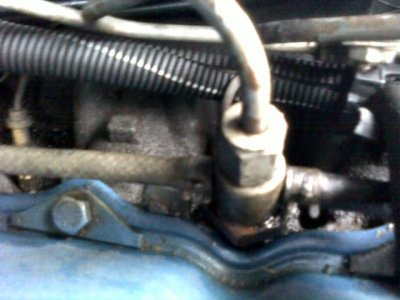

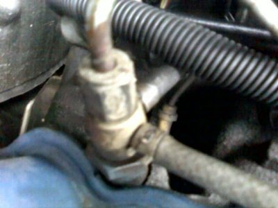

Is there a way i could take a picture and post it on here, could somebody tell?

If there is a steel, dedicated line on top of the intake for the ip return, it is the early style. If the ip goes to the return caps on the drivers side, it is the late style.

I still dont know what to look for, can anybody help me with these pics?
