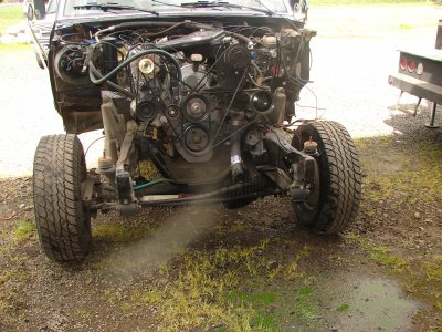

Here is a pic of mine, just left of the water pump pulley.

There is another way to stop the flop... Use a shorter belt that doesn't reach the crank pulley. I have seen it done and it really helps. The belt goes around the waterpump and alternater only. So you don't have the long drive from the crank to the alternater which drops out most of the flop. Someone will post the belt number.
