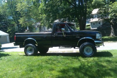

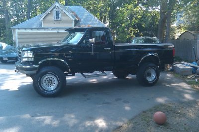

i attached 2 pics lets see if it worked. but really thats it only a weekend? i figured it would take about 2 weeks lol.
