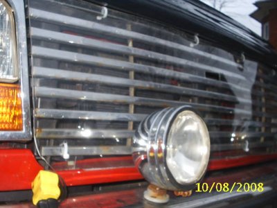

This is what I run. It will hold 190 on the gauge in 20 degree weather. I thought about covering the bumper cutouts too because I'd like to see 200-210 on the gauge.
