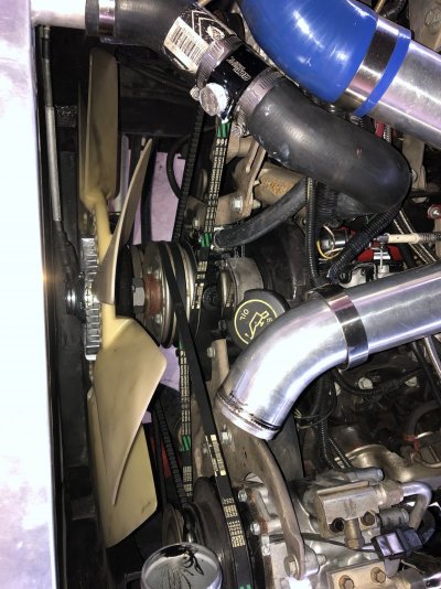

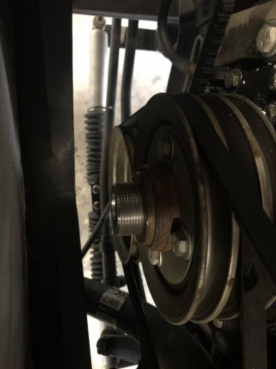

Just to catch this thread up, I did fit the 6.4 fan and fan clutch with adapter bushing. I have one trip on it and that combination seems to work pretty well. I haven’t put it to the max stress yet (I-68 with the AC on) but on the trip to Michigan last fall, kicking the fan on kept it cool enough to actually drive it. The PA turnpike is not as steep as I-68 but there are a few decent pulls. I do need to go to a progressive controller for better results.
