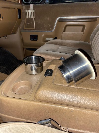

I only comment cup holders when someone else does I'm still rockin' my mech pump
I am still on my mechanical pump until I see the need for a change...my truck sits more than it drives...it is just a tool box,crane, welder, and air compressor with a vise mounted on the back...kind of a mobile workshop for the time being...
As far as cupholders go...you guys have ruined me....I see cupholders everywhere...dedicated cupholders and potential cupholders...
I wake up in a cold sweat...dreaming about cupholders on the march...
...swinging spitball straws and big gulp containers...cupholders massed for a flash mob and cupholders rioting in los angeles and virginia beach.
Cupholders demonstrating for liquid justice and non-uniformity of ice cubes...rainbow cupholders and basic black cupholders...
Cupholders waving the hammer and sickle and cupholders waving old glory and both groups glaring evilly at each other...daring them to flinch...
I may never get over it...cupholders are everywhere....
Quick...wave something shiny....
