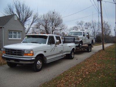

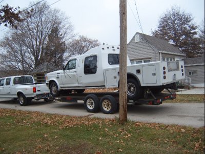

I went to Iowa yesterday and got it picked up. The truck looks a little better than I expected so that is good. It started right up and drove on the trailer. I really didn't hear a "nock" from the motor but it didn't get warm yet either. I will let it run today for a while to day and see what it sounds like.
There is so much stuff on this thing, Big oil coolers, a pre and post luber, (I never heard of a post luber before) triple oil filter's, the turbo is a NEW Banks, ( might go on my tuck). Basicily it was exactly as advertised so I am happy!
The thing is a BIG TRUCK! Here are a couple of pics taked in Iowa after loading it up.

Yep, pre luber and post luber, When you turn on the key there is an electric motor that pumps oil through the motor before you fire it up, then when you shut it off, it runs for another minute to pump oil keep pumping oil while the turbo cools down. that way the oil doesn't stay in the turbo boiling out if it is too hot at shut down.
I will investigate it more early this week and get some pics, right now it is still on the trialer waiting for Ken to come and take a look at to see what it needs. I personaly think there is no problem with the motor;Really

Yup, It is a PSD, I took it on trade on a 97 F350 CC Gassar last week, it ran real nice, has all of the Banks upgrades, and rear air bag suspension, so it was a great truck to make the trip with.
