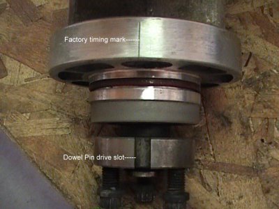

The best and easist way to know where you timing is was taught to me by Mel at the 2009 rally. A center punch mark made in the injection pump to housing joint tells all. It must be made directly between the two pieces that move. Then when you move the pump the center punch mark circle becomes two differant half circles. In the machinst world its called whitness marks. Makes some other guys problem of reassembly easy. Just match up all the marks. Some of our pump rebuilds in the steam generation business had 15 stages of a pump on one long ass shaft.

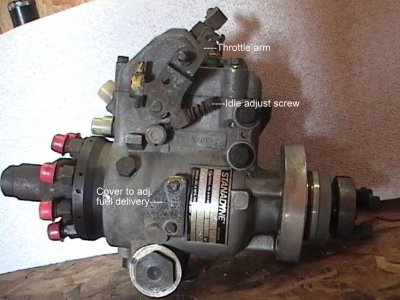

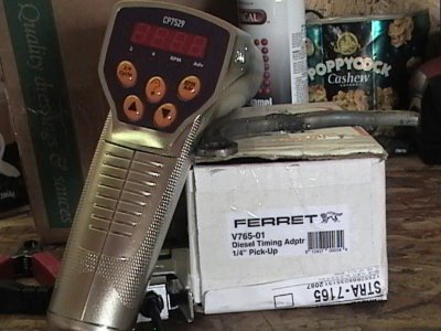

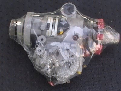

I assume you know what an injector pump looks like, pic is one that is not yet mounted. Now if you look at it, on the oposite end of where the steel lines are connected you will see there are three (3) nuts threaded on three (3) studs, one nut on top, one nut on each side close to the bottom, each nut requires a 9/16" openend wrench to loosen them, there are special C shaped thin box wrenches for the bottom two (2) nuts. pic shows wrench on top of box. Now after marking (center punch) the mounting flange, as icanfixall said above, loosen all three (3) nuts, move (twist) the IP body to your left (or passenger side of the vehicle), about the thickness of a Dime ( a Dime is a US coin), then tighten all three (3) nuts. By doing all of that you have in effect advanced the engine timing about three (3) degrees, moving the IP towards the drivers side will retard the timing. With out a timing device, you cannot tell exactly what the timing is set at. It should be at 8.5 to 9 degrees (before number one cylinder piston is at top dead center--ie:BTDC).

On the IP gear tower, below where the oil spout is, is a cover held on by two (2) bolts, remove that cover, then you will see the IP drive gear, There is a dowel pin that drives the IP along with three (3) bolts that hold the IP to the gear, DO NOT loosen them. Now rotate the engine by hand, 15/16" socket on the bolt that holds the damper pulley on, rotate engine so the dowel is at 12 O'clock, with the cover off the IP the hole to adjust the fuel should be there, if not, rotate the engine one more turn, so the dowel is at 12 O'clock. Now you can stick a 5/32" hex key in and adjust the fuel, ONE OR TWO FLATS OF THE HEX IS PLENTY, USUALLY THREE FLATS IS MAXIMUM put both covers back on, use a little RTV on the front cover. Start engine, reving to WOT (Wide Open Throttle) should make the exhaust puff a cloud of smoke black, driving down the road with WOT should make a cloud of black smoke for about 100 feet. The pic below shows the IP driven end with dowel slot and the three bolts that hold the IP to the gear.
