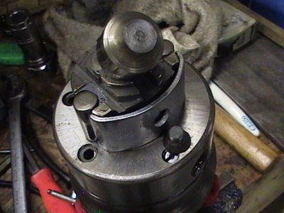

Adjusting the fuel screw spreads the C ring which pushes two rollers out that in turn increases the circular motion of a cam that rides on the rollers, the cam increases the stroke of the plungers that delivers the fuel at a high pressure (5000+ PSI) to the injectors.
Heres a pic of the C ring and rollers. The shaft was sheared on this particular IP because the adjustment was too much.
