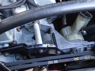

Here is a picture of the PS pump with AC deleted, and the alt bracket minus the alt.

Looks like you completely removed the bracket that the A/C pump bolts onto. Did your PS pump come with the dual belt pulley?
TahoeTom
May 19, 2010
749
113
S. Lake Tahoe, CA
That is the way non AC trucks were. I found some stuff at the junk yard. I never thought about the double pulley, but now I see some are single. I figured I would run two belts since I have hydroboost and if one fails I still have brakes.
