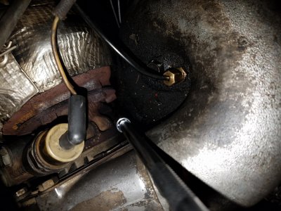

I know there are already things on glow plugs but I just finished doing mine and want to help a couple people that have turbos and don't want to remove it and can't really get to the glow plug under neath of it I let all my plugs soak in kano spray for a day before trying to get to them I used a 1/4 drive with a couple extensions and wobbles to get the plugs out the one in the back under the turbo was the hardest one for me to get i had to put the deep well socket and the wobble first by reaching around and under the back of the turbo then kinda held the wobble pointed toward the turbo hat then stuck a skinny long extension between the turbo and turbo hat that was the best way for me to get to the glow plug and get it out lucky I didn't have a problem with mine

on #7, i used 3/8" drive, a 12" extension, and 1 wobble.
i went under the exhaust housing of the turbo.
the other 7, i did with a short deep drive 10MM 1/4" drive socket with 1 wobble.
