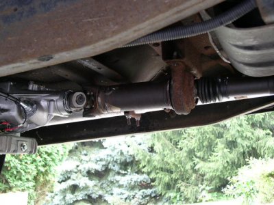

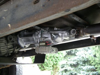

Here's a few pictures of it mounted. Fivepuller, it's about 2 inches below the bottom of the cab. I thought it was going to hit but theres plenty of room.
It looks about like what I have. Is there a cab cross member above the gv adapter. If it clears yours it must clear my '92. Nice short shaft. ;Sweet Glad everything worked out ok.
Yeah, one above the adapter & the next one back is right over the yoke on the GV. You can see that latter in the pic above. Even with the one over the adapter, I still had enough room to get my hands in there to bolt up the OD with no trouble. Let me know how yours goes.
