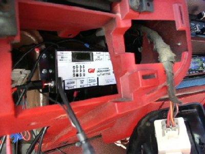

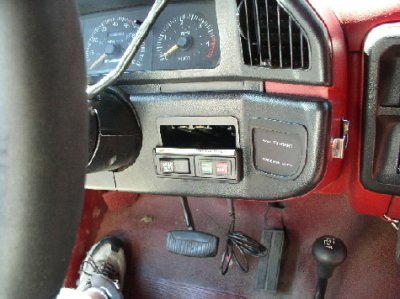

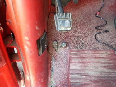

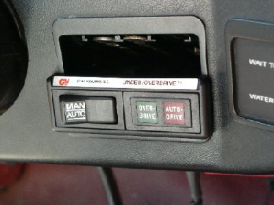

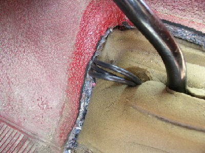

Quick question needing a quick answer. I have the 2 piece rear shaft. GV says if the front shaft is 26 inches or longer, cut the front shaft. Then it says 26 inches or shorter cut the rear shaft. My shaft forward of the carrier bearing is exactly 26 inches. After measuring it out based on the overall lenth of the GV, that will leave me with a front shaft of about 11 5/8 from the center of the yoke on the GV to center of the carrier bearing. Is that acceptable for a shaft length? I've never seen one that short. If I need it longer I will have to move the carrier bearing back & shorten both shafts I guess. GV made it sound like the front shaft is all that would need shortening. Anybody please chime in. I got the electronics all buttoned up so I'm waiting on shaft decisions. Here's some pictures of what I have done so far. Thanks for any help in advance.

trying pics again
