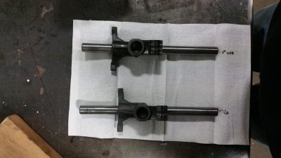

Update, the 47's internals did all fit into the 42's case. I used the gears, forks and shift rails from the 47. The one oddity I came across is that the positioning of the socket for the shift tower is closer to the front of the transmission on the 47. For this reason I had to use the main shift rail from the 42 as the shift arms did not line up with the internals in my 42 case. I fear I boogered up on the end play tho. There is a significant amount of gear noise when idling in neutral. If I push the clutch in the noise stops. Bummer.
