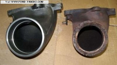

if your going to run g code injectors then you need to run them with the factory turbo idi pump, cause they are calibrated for each other, the reason the factory turbo trucks were so weak was because the outlet housing on the turbo was smaller than ats intended, and the downpipe was cruched for "clearance" and that made it to were it couldnt make as much power as it could, i intend on doing the 6.2 governer spring mod one day, just realise one thing if you blow your motor its your fault, here is some pictures of the outlet housings and down pipes as you can see the ats parts on the left and ford parts on the right big difference!
